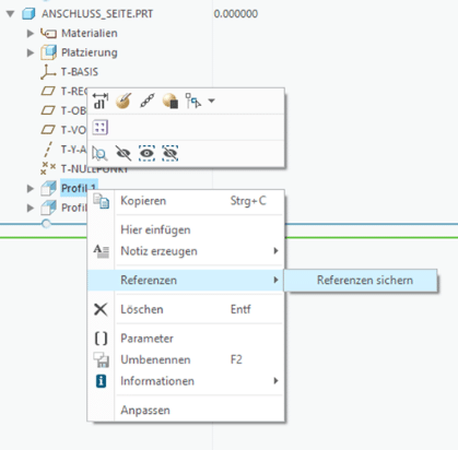

This method is intended for external references that come from a Creo construction element. A simple example are e.g. B. two holes that are in different parts of a Creo assembly and must be aligned. That means: one hole is the reference for the second. I can simply save the reference of the second hole in Creo Parametric (1) and then have full control of what happens to the hole when the source is updated.

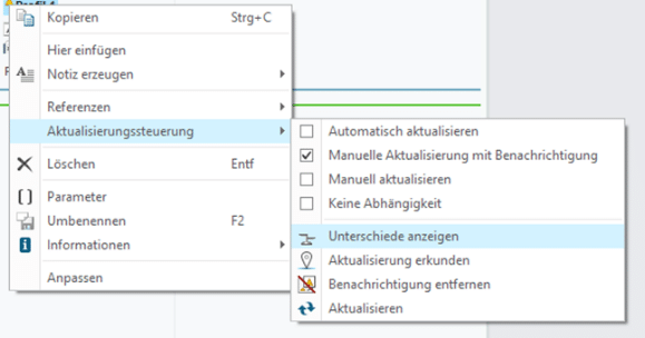

Now I have the option to choose from four different options (2):
- Update automatically
- Manual update with notification
- Update manually
- No dependency
I have z. B. "Manual update with notification" selected, I will be notified when the reference has changed.

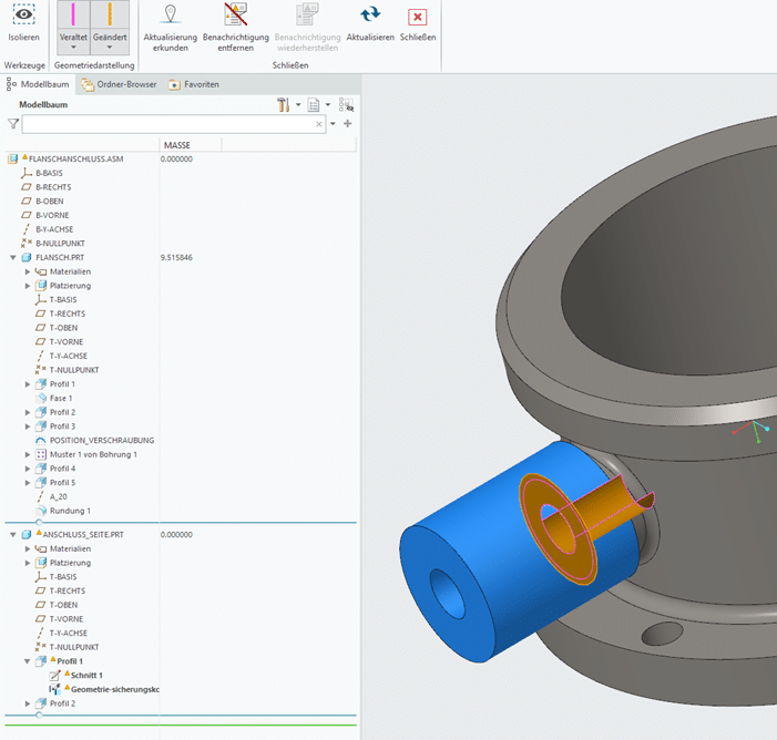

In the "Show differences" tool, I now see which references have changed by highlighting them in colour.
The "No dependency" option breaks the reference permanently and cannot be undone. Creo construction elements (KE’s) can be referenced afterwards or e.g. B. edited with Creo Flexible Modelling.

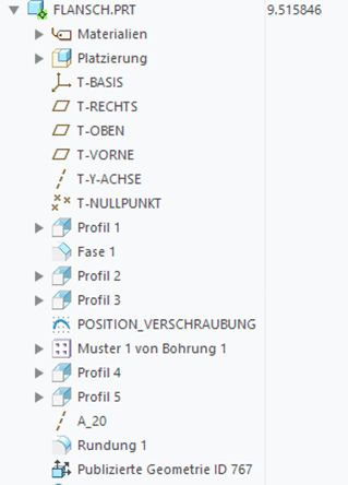

Creo publishing geometry

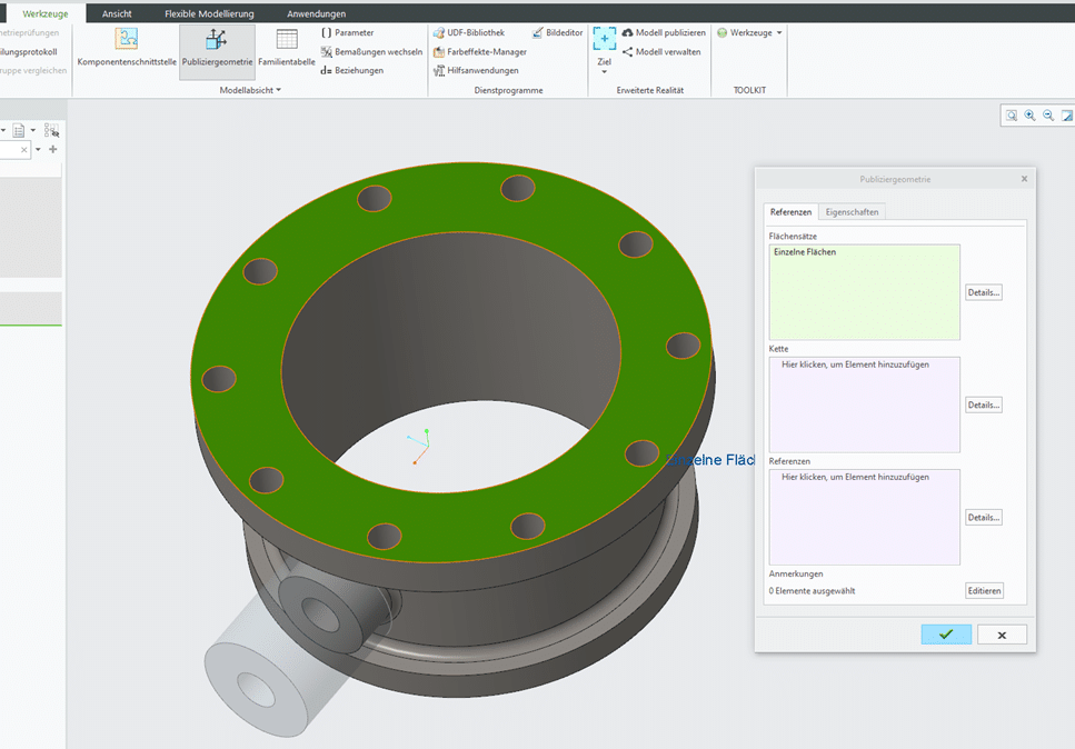

The question often arises: How can I e.g. For example, use a complete surface to create a new Creo part in a Creo assembly? An ideal way is to use the publishing geometry function.

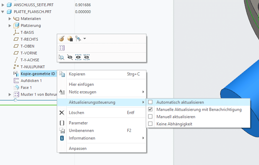

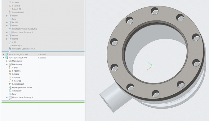

In the example, the flange surface is published. I can then see the published geometry in the Creo Parametric model tree. From here the part can now be processed normally. This can be done either parametrically or with the Creo Flex Modelling Extension. In the case of an update of the original Creo part, the already known options for controlling the reference are again available to me. In the example below we have e.g. B. uses the "Thicken" tool.
