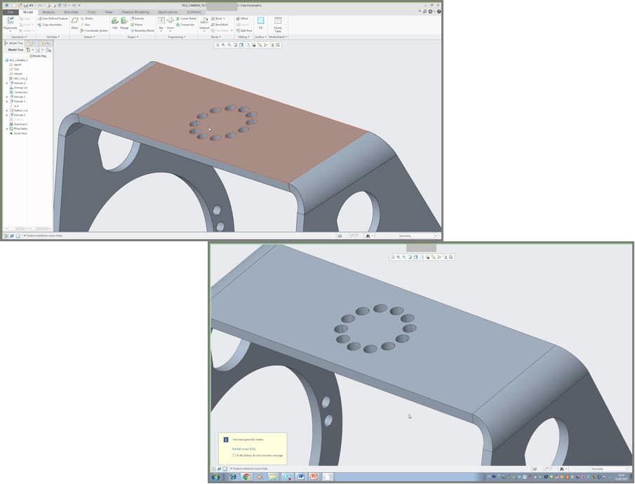

Selection and Mini Toolbar
A great improvement is the new Mini Toolbar that pops up when something is selected in the model or in the model tree. A typical measurement is the number of mouse clicks required to do an operation and the new tool will decrease number of mouse clicks with over 50%. This is also how the geometry is selected in the model. Directly in the selection the user are given geometry as the first choice, previously it was the feature and then the surface/edge/point. After the selection, the new Mini Toolbar gives access to the feature if needed, otherwise the user keep working from the Surface.

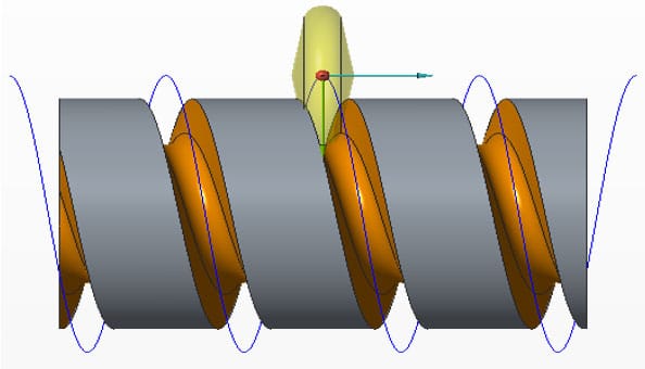

3D Sweep
A completely new feature in Creo 4.0 is 3D Sweep. It´s a solution to a problem that has existed since the birth of 3D graphics and the use of the sweep in models. It´s a problem that is based on a mathematic problem. Before the user has only been able to sweep a 2D profile along a 3D path, which actually has given wrong geometric results. This is something that designers usually don´t have thought much about, but if the user should design a trai
l that wraps around a model and a roller shell follow the track, the user will find that the track cannot be created properly. This is now solved with the feature 3D Sweep which sweeps 3D shape along a curve and this gives a completely accurate geometry that a milling or a grinding wheel can create.

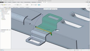

The new improvements in Sheet-metal will make every day easier for every designer. It is possible to close the corners for a more welding appearance. Twist Wall has now a dashboard and there is also a Mini Toolbar in Sheet-metal.
The best news in Sheetmetal is that we finally are able to use Flexible Modelling in Sheetmetal. It is something that we users have been waiting for and it really gives what you want when it comes to manage with this type of design. This works also for imported geometry and solid models converted to Sheetmetal. When I uses Flexible Modeling in Sheetmetal so I now understand why it has taken so long time to add this functionality when I see how great Creo manage the complexity in a seemingly simple model.
